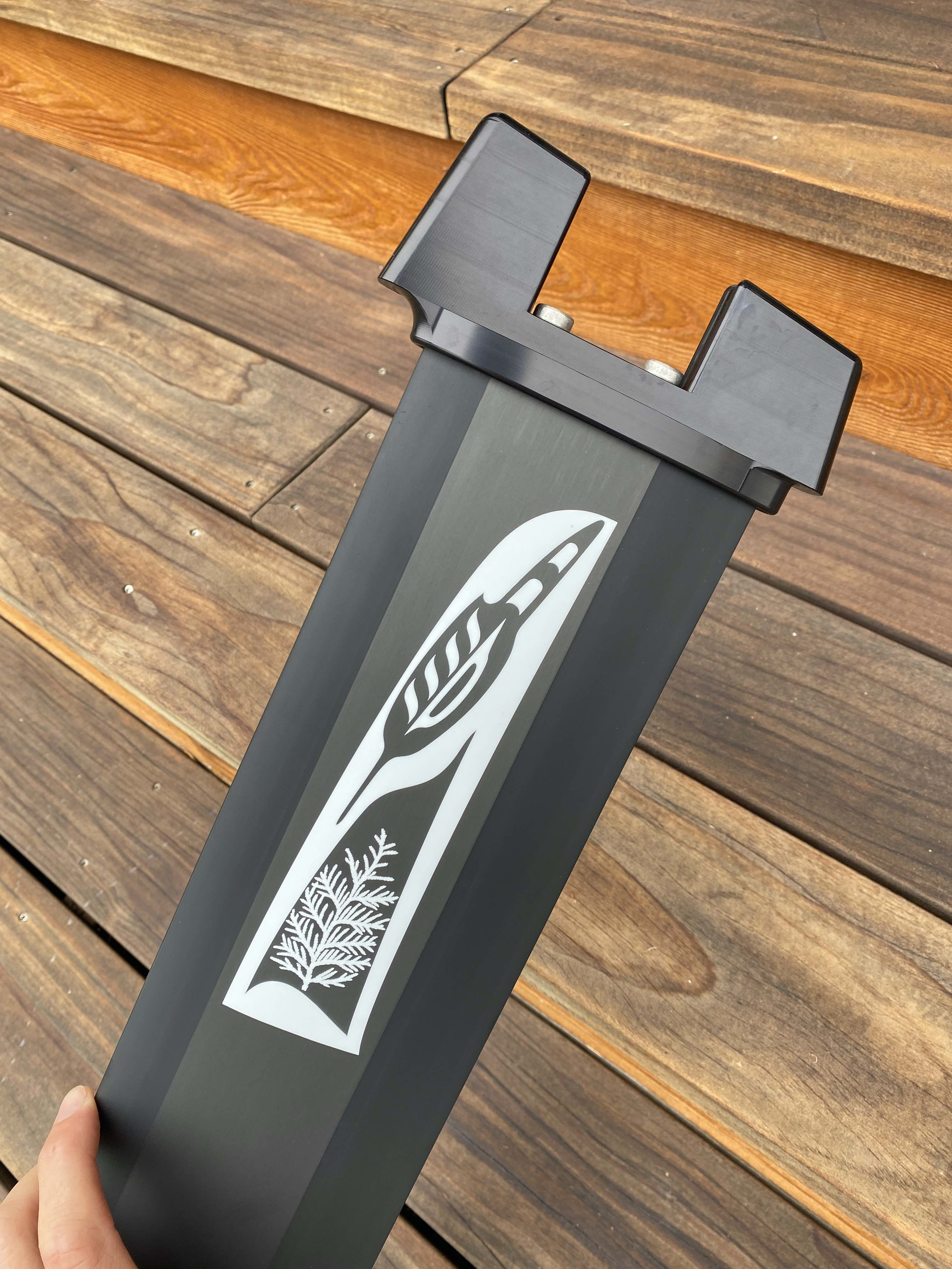

First mast on Vancouver Island!
Thank you Peter for your patience while I designed these custom adapters and board mounts for you. I wish I could cross the border to hand deliver it! Enjoy the ride, Kyle
- Custom Made
- Serial.jpeg (764.79 KiB) Viewed 8484 times
- SS B/C Position Adapter
- SS_BC.jpeg (947.8 KiB) Viewed 8484 times
- Slingshot Tuttle Mount
- SS_Tuttle.jpg (785.06 KiB) Viewed 8484 times
