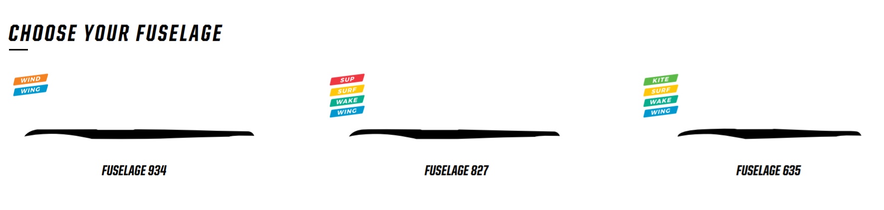

While we are talking about fuse size I discovered something the other day while shopping for a new foil. The Moses fuse at the front extends over the top of the front wing so the 710 Moses fuse would be close to the 60cm Armstrong. Sorry if this has been covered before but I just found out and thought I would share. I would assume that might be similar for the axis as they look like a similar construction to the Moses.

fuse
The Phantasm also overlaps the wing/fuselage significantly. I just noticed it says the Moses wings will fit on it as well! Now I'm getting excited.
- fuse.png (380.55 KiB) Viewed 7261 times
- fuselage.jpg (53.01 KiB) Viewed 7261 times
