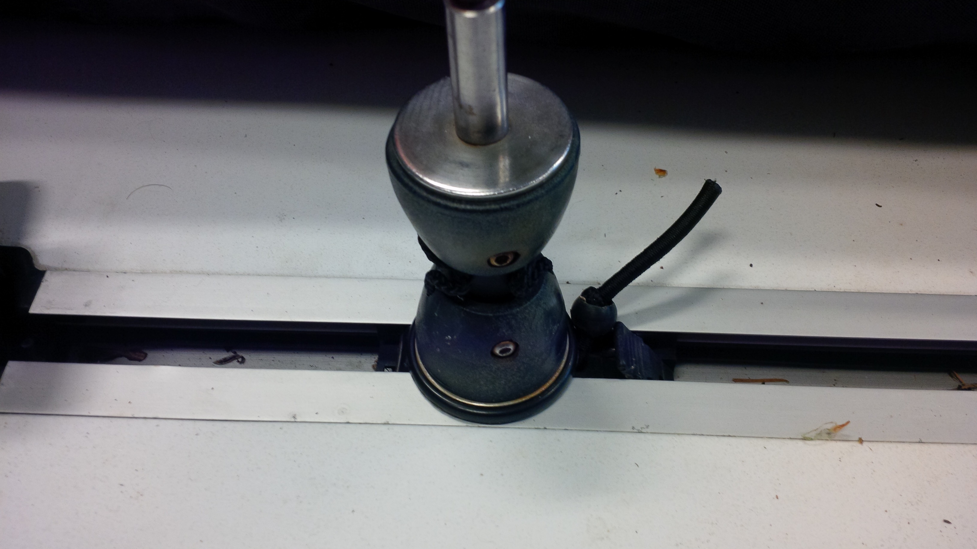

My neighbour gave me a Neil Pryde RS:X that is a little beat up and I want to use it with big gear. Luckily I have a fin for it and a suitable rig. However, it has a europin base on the board and my rig has a US mast base.
Does anyone know how to remove the mast base from the RS:X?
There is a plastic tab in the front, but it is not moving very easily and I don't want to break it.
I will try upload a photo.

I have the same track on my Prodigy. When you pull the tab up towards the base it releases a retaining clip allowing you to pull it out. Spray some lube on it and wiggle till it loosens up.
Thanks, got it! Now to attach a regular US base to the RSX tendon base!

It's been awhile since I've sailed one, but if it's like the IMCO and I believe it is, there should be a screw at one end of the mast track that a Chinook bolt can screw into.
