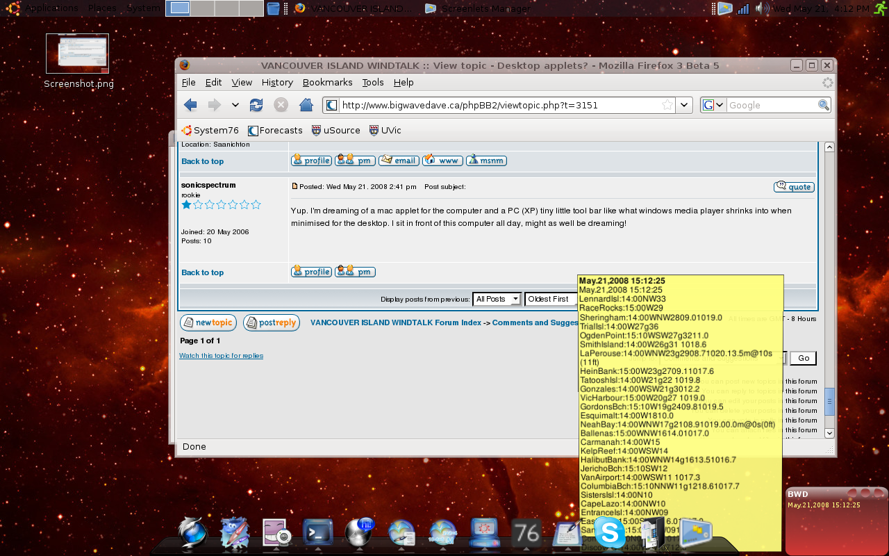

success.
with compiz and screenlets, I have the RSS feed on my desktop that is updated every five minutes! Love it! Thanks for the suggestion RD.
Here's what it looks like:
