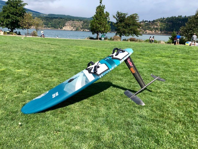

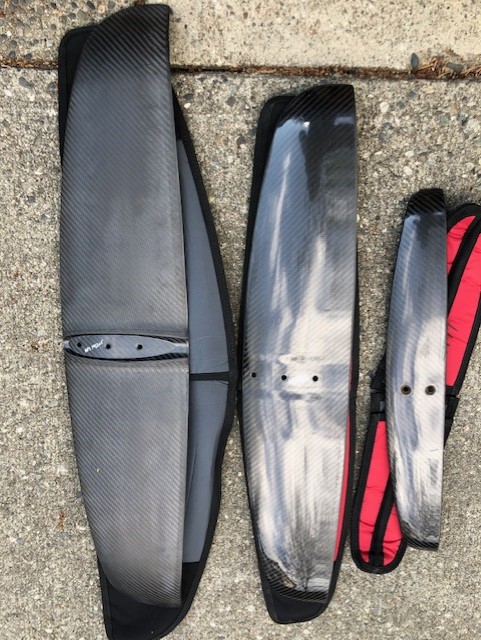

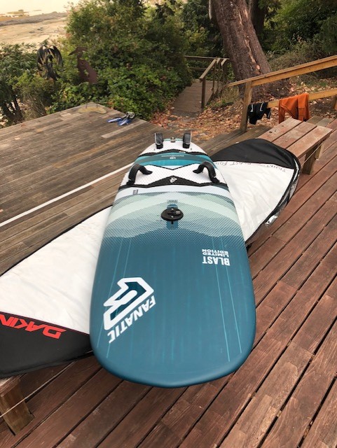

Here's my windsurf foiling set up.
Board:
Fanatic Blast 145L Foil/Freeride board, deep tuttle built for foil, 235cm x 77cm...ya it's big but the Blasts sail small, it rips with a 38 cm and 44cm fin and a 6.2M in 15....super fun to jibe. Feels like the old Harrison Lake days on my 6.5M and JP Freerace 142L.
Foil:
AFS-2 carbon freeride windsurf foil
Deep tuttle
85cm mast
90cm fuselage
Front wing #1: 1,120cm² (7-15 knots)
Front wing #2: 780cm² (16-30 knots)
Rear wing: 320cm² (all)
3 sails: 4.8M, 5.3M and 6.2M. That's it!. All Sailworks Revos, with 3 RDM masts. I had a 6.0M Flyer, but think the Revos are better for me as I can use also them with my 96L Fanatic FreeWave tri.
I found this windsurf foil set up to be very balanced the few times I sued it....when I bought the board, I measured it against one of the pure foil boards at Sailworks, and it was pretty close. I have the front footstraps all the way forward.
First day foiling on this at Nitinat I was flying on the foil on my 1st run, and by 4th run was sailing on the foil, in both footstraps, and hooked in the harness, feeling very balanced, planing in very low winds (barely capping) on a 6.0M Flyer, using the small front wing. I don't think I'm that good a sailor, so I think the set-up is pretty balanced. I actually have never used the big front wing, which should be much better in low winds, and more stable. Looking at the pics of the wings....the bigger wing is way bigger and should make me go in very little wind with the 6.2M.
Would love to hear/see more windsurf foil setups and gear info.

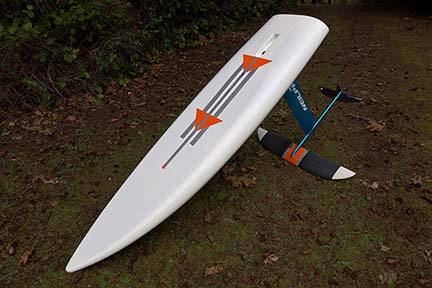

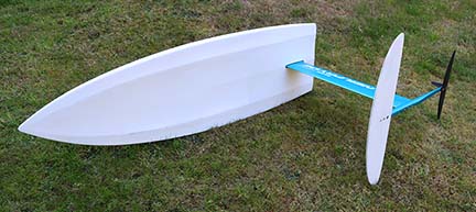

I started windfoiling on Keith's first setup - the Roberts flapper and the original Slingshot H2 setup.
I pretty quickly determined the board was too big and used the Powerbox adaptor on my Fanatic Skate 110l. It was awesome, except I was very nervouse about the single powerbox screw holding it all together.
As "luck" would have it, I lost the entire foil on my last day on the lake when the2 powerplate to mast screws sheared off (man. defect).
Slingshot sent me a brand new set as a replacement.
In year 2 I had MFW cut down the Roberts to make me Frankenboard Mark I. I also had him fill in the flapper slots and strengthen the fin box as there were creases starting. Same thing with the Skate - so he reinforced that as well.
Frank 1 was great and I added an Infinity 84 for the sub 10 knot days.
Frank 1 must be about 110-115l or so, I think and is super stable.
My sails are Ezzy Zeta's from 4.2 to 5.8 and I have an older Ezzy 3.7 (for the higher wind days).
In year 3 I sold the Skate and bought another Roberts board for MFW to convert into Frank II.
I also bought Grantmac's Slingshot set to get an Infinity 76.
I pretty much use the 76 80% of the time and the 84 20% f the time. (84 on Frank I with the 5.
Frank II is a lot "smaller" and has maybe 90l volume. I had MFW reinforce the tail and put in a trackbox, which I haven't used yet.
I run the 76 in position C and it is super balanced 9now, not at first).
It was a challenge getting used to the setup and I have it pretty dialed now and gybes are coming along nicely.
i have taken the back bootstraps off both boards and like that setup.
So, I have 2 boards - "bigger" and "floatier" Frank I that I use with the 84 and 5.8, and then Frank II that I use with the 76 and 3.7 to 5.2.
This year I will see how the 84 works on Frank II to see if I can go to one board.
I am also going to learn kitefoiling as well, just to keep it interesting.
Here is a pic of the 2 Franks.
