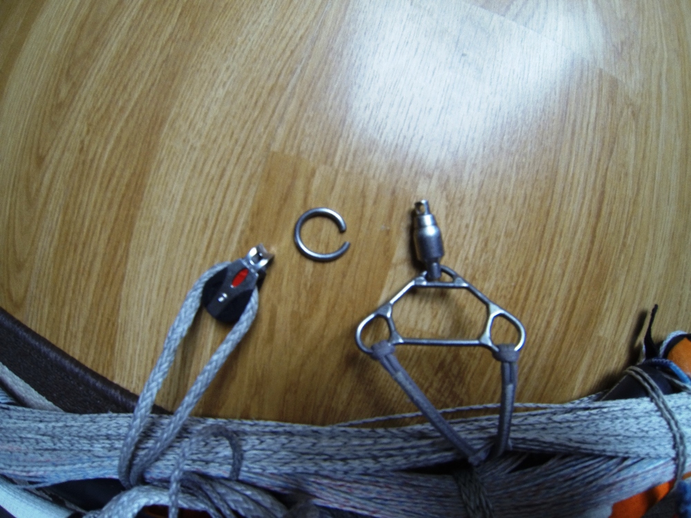

Pulley to Swivel Ring
wanted to clarify what happen Friday evening.. I had twist above the spreader bar in my two centre flying lines when launching and thought they'd sort themselves out with me twisting the trim line. improper loading to the ring is the probably cause.... user error etc... I knew it wasn't right..it wasn't fixing itself and thought I should head in and was soon about to before it happened!
I've used the bar for close to one year and its possibly close to two years old. I've cleaned it after every use and checked line lengths often enough but probably only inspected the spreader/swivel/pulley/ring connection once or twice..
lessons learned were: make sure your lines are flying properly with out twists/knots/chafes/out of tune lengths, when you know something ain't right go back the beach and fix it, learn how to swim better with a dam harness on or attach flippers to your harness, help a kiter in need (without the help of Ian and Paul I could have been a lot worse off)
Ocean Rodeo have already said they'd get me riding the bar again... Richard today said he'd like to take a look at the ring and view the clip and pictures from my GoPro.
I'm very happy to have not had anything worse happen! my kite got a small tear in the leading edge and some scratches that should be easily fixed with a small stitched patch. the bladder seems fine and held air during my first inspection. The cops didn't threaten to charge me like Oak Bay PD said on Willows, but they still took my name.

- GOPR0537.JPG (404.41 KiB) Viewed 8834 times

getting a rap sheet with the po-lice...."a Victoria kiter, known to the authorities".
Looks the weld failed on that ring....I'd call that pure freakish mechanical failure.
You've now got JL, aka the "mad professor", searching the web high and low for higher quality swivels, plus additional twine redundant systems, etc.
But with the ring failing, not the swivel, these wouldn't work anyway. Plus I'd be sketched at introducing safety systems that cause your swivels to potentially not work right. Lots of stories out there about excessive line twist leading to failure of the quick release.....i.e., release and it doesn't depower....leading to either also releasing secondary release (bye bye kite) or a death loop spiral into who knows what. Yikes! Keep those flying lines untwisted.

It's not an isolated incident. http://oceanrodeo.com/forums/viewthread/3697/ That's 3 more.
I also disagree with the little spreader bar above the swivel not having the ability to support the 'oh shit' release. Something like http://www.mutinykites.com/content/mutiny-swivel-0 eliminates the need for any welded rings as well
p.s. If your using an O.R. bar older than 2009 there was a recall on the swivel. The new one on the left & the old one on the right: http://oceanrodeo.com/_inc/phpthumb/php ... 26c3d5.jpg

For the record I'm going to miss that O-Shit release ring coming through the one side of the spreader. To be able to put the full load on that one front line from that ring was invaluable. It saved my ass more than a couple of times. It looks like the new OR bar doesn't have that as a stock set up.
