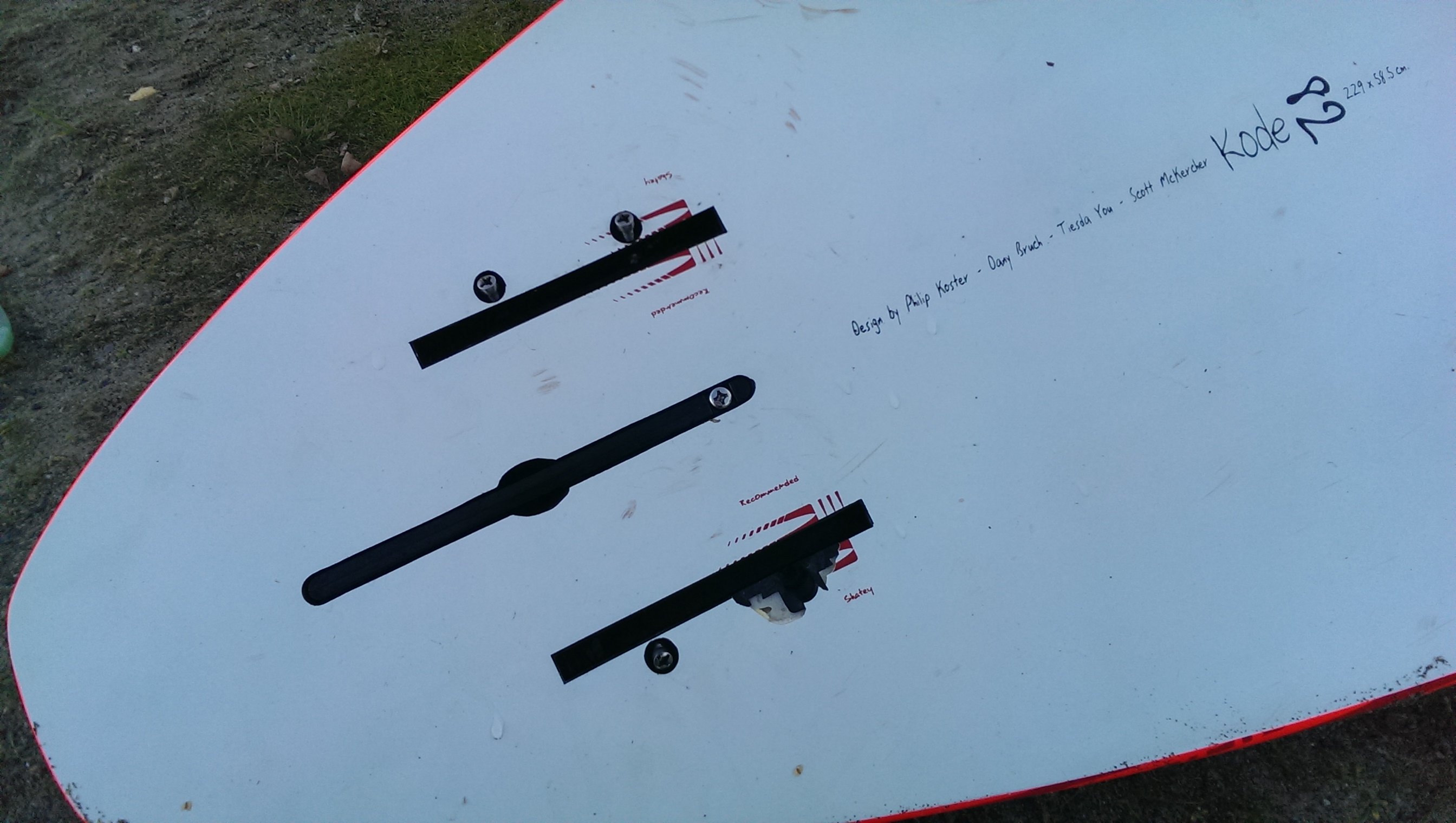

Hey guys,
Unfortunately I totaled my spankin' new Kode 82 on a submerged log last Sunday at Jericho. Destroyed both the slot boxes, and have already got a date lined up with Rob Mulder to get my baby under the knife and fixed up.
I talked to one of our team guys who also destroyed his Slot Boxes on a reef, and got them replaced with short US Boxes. I'm now thinking I should probably do the same with my board, cause if I get new Slot Boxes put in and I total it again on a log/rock/reef/stump/etc, I'm going to be pissed!!
Thoughts?

yep, Jellyfish found a Chelonioidea once at good speed, cracked the internal portion of the twinzer (quad) box as well as some of the surrounding bottom deck (not sure about the other deck, poor thing, interestingly they eat a wide variety of plant and animal life, including insects, crustaceans, seagrasses and worms but some feed almost exclusively on jellyfish :lol: ) could not be repaired/sealed and required re/re :x Poor Quadrella #1, no different than any other box I am afraid.
I cracked a main power box and was able to seal the area around the crack and reinforced with stainless U without requiring removal, still a lot of work :roll:

I've decided I'm getting US boxes put in instead of Slot Boxes.. if anyone wants to buy my Makani Walu 2 Weed 15cm (Slot Box), let me know.

Powerboxes are definitely the strongest, sadly they don't use them/make them for multi fin boards...
2 summers ago I hit a stump in knee deep water in Squamish going mac-10 with my JP FSW. Hyperextended the crap out of my back (felt it for over a year after the crash) and was convinced the impact was hard enough to have split my board in two, but alas, the great JP lived on! My DIY thruster conversions were holding up great until my latest log encounter...
Downwind Dave, both the slot boxes are cracked internally so the originals have to go. I get a bit of industry lovin' through work from the Makani crew, so a new set of fins doesn't hurt quite as bad 8)
After some more thoughts and conversations on the matter, going ahead with the US-box conversion. Getting 8" US boxes from Chinook, and the board goes in with Rob in about a week or so.
